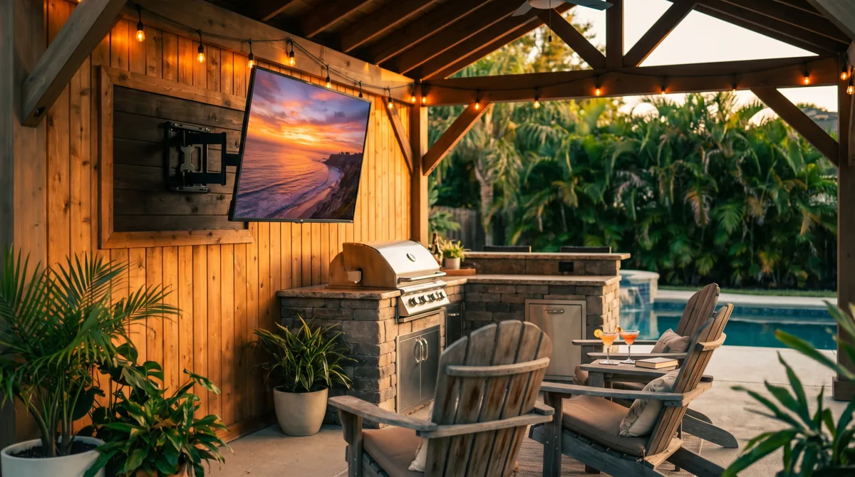

55-inch outdoor TV wall-mounted on a stacked-stone accent wall above an outdoor kitchen at golden hour
A typical patio install — 55" outdoor TV in partial-shade conditions, about 1,500 nits is plenty here.
