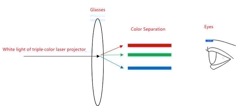

The lenses of eyeglasses are usually made of glass or glass resin, and this material also has different refractive indices for different wavelengths of light, thus producing different refraction angles for different wavelengths of light.
We know that the color of the laser is very "brilliant", that is, a single wavelength, the narrow bandwidth of light. But it is almost impossible to have such a single wavelength of light in nature. Monochromatic light in nature is a continuous broad spectrum light compared to laser light.
The projected white light of the tri-color laser is incident on the lens of the glasses, and these three laser colors produce different fold angles, and because the bandwidth of these three laser colors is very narrow, a large part of the spectrum is missing in the middle, which makes the three laser colors pass through the glasses and produce fold angles without overlapping each other, and therefore produce color separation.
There is another reason why color separation is worse if you look at a trichromatic laser projector with your glasses on at an oblique angle. That's because when squinting, the trichromatic laser light is obliquely incident on the lens, the light takes a longer path through the lens, and the color separation is more severe.
Similarly, the deeper the myopia, the thicker the lenses of the glasses will be, and the color separation will be more serious. And if we change the direction to look obliquely, this color separation will also change over with the direction.
Why does astigmatism occur when I wear glasses to look at a panchromatic laser projector?
Let's take a look at the promotional chart of a panchromatic laser projector, the light source of projection is composed of three beams of red, green and blue laser.We know that the color of the laser is very "brilliant", that is, a single wavelength, the narrow bandwidth of light. But it is almost impossible to have such a single wavelength of light in nature. Monochromatic light in nature is a continuous broad spectrum light compared to laser light.
