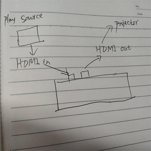

The second scheme: home theater audio cable active echo wall
1. If the HDMI line is laid between the TV table and the projection, the echo wall scheme shall be used. We shall divide it according to the number of interfaces and audio behind the long bar, and the figure with two HDMI interfaces is as follows:
2. With an HDMI echo wall and an HDMI arc interface, this is usually used for TV sets. TV sets have systems and loudspeakers, so the audio echo function is needed to send out the sound that should be emitted from the TV loudspeakers and the echo wall. This is the function of this HDMI arc, so how to use this interface flexibly when the projector encounters it, because the box generally has only one HDMI Out interface (other words with audio-visual separation), the overall direction is that HDMI is directly connected to the projection, and the rest of the playback source and echo wall are connected to each other. If the low-end box is not connected to my interface, then we can find a way to let it have one. Buy an HDMI audio separator and connect it to the back of the playback source, HDMI of the separator When out is connected to the projection, the upper audio port is connected to the echo wall, including the corresponding port. Coaxial first.
