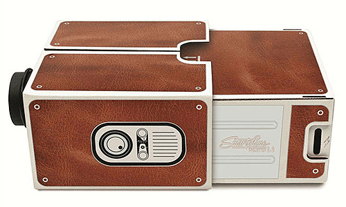

There is basically no cost, and you can also make a simple projector at home. Methods as below:
1. Prepare tools such as magnifying glass, knife, tape, paper box, etc.;
2. Remove the lens of the magnifying glass from the handle, use a knife to cut out a circular hole of equal size on the carton;
3. Use tape to fix the lens on the carton;
4. Turn the phone upside down, adjust the brightness to the highest level, place it in the carton, and align the light source with the lens.
When fixing the magnifying glass on the carton, make sure it is sealed and no light will leak out. When you turn on the phone and close the carton, you need to fine-adjust the position of the phone so that all the heads can be projected onto the white wall. .
