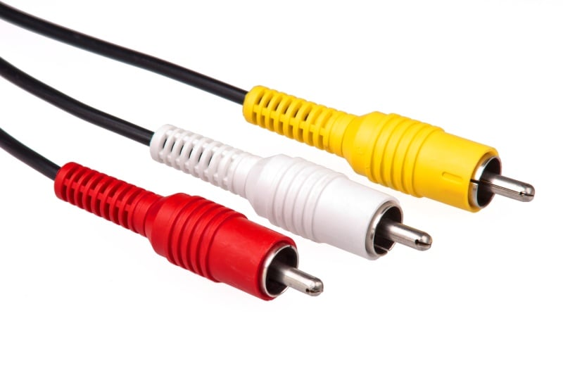

Your VCR typically outputs its video and audio signals through RCA cables. These are the iconic cables with:
  • Yellow plug: Carries the video signal.
  • Red plug: Carries the right audio channel.
  • White (or sometimes black) plug: Carries the left audio channel.

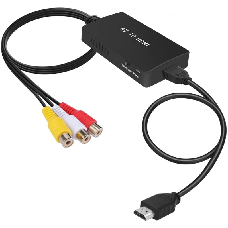

The magic gadget you need is an RCA to HDMI converter (sometimes called an AV to HDMI adapter). This small box takes the analog signal from your VCR's RCA cables and converts it into a digital HDMI signal.
When buying a converter, consider:
  • Powered vs. Passive: Most reliable converters require external power, usually via a USB cable. These are generally better than passive ones.
  • Resolution Upscaling: Some converters claim to upscale the VCR's standard definition (480i) signal to 720p or 1080p. While this can make the image look slightly better on a large HD or 4K TV, don't expect miracles. The source material is still old, low-resolution VHS.
  • Reviews: Check user reviews to ensure you're getting a reliable model.

  2. Connect VCR to Converter:
    • Take your RCA cable. Plug the yellow, red, and white connectors into the corresponding RCA OUTPUT jacks on the back of your VCR. (Yellow to Yellow, Red to Red, White to White).
    • Plug the other end of the RCA cable into the RCA INPUT jacks on your RCA to HDMI converter, again matching the colors.
  3. Connect Converter to Smart TV:
    • Take your HDMI cable. Plug one end into the HDMI OUTPUT port on the RCA to HDMI converter.
    • Plug the other end of the HDMI cable into an available HDMI INPUT port on your Smart TV. Note which HDMI port you use (e.g., HDMI 1, HDMI 2).
  4. Power the Converter:
    • If your RCA to HDMI converter requires external power (most do), connect its USB power cable to the converter and the other end to a USB power adapter (like a phone charger) or a USB port on your TV (if it provides enough power).
