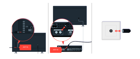

2.Check the antenna and input cable connections.

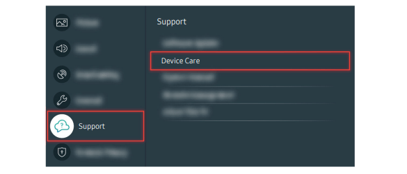

8.If the same problem persists, run a diagnostic test. On the remote control, press the home button. Select Settings>Support>Device Care>Self Diagnosis>Picture Test.
9. When a message appears, select OK and follow the on-screen instructions to complete the test.
4.Check the antenna and input cable connections.
