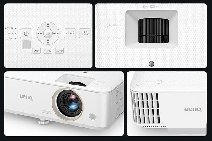

BenQ projectors are divided into two types: smart micro-projectors and traditional light bulb machines. Among all products, the proportion of traditional light bulb machines has reached more than 90%, among which the representative models are BenQ TH685, i707 and W1120. This type of projector has a zoom ring with a handle in the groove above the bulb. You can rotate the zoom ring left and right to adjust the size of the screen.
