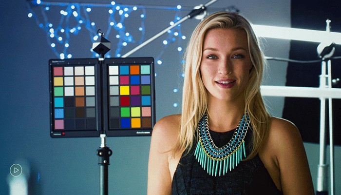

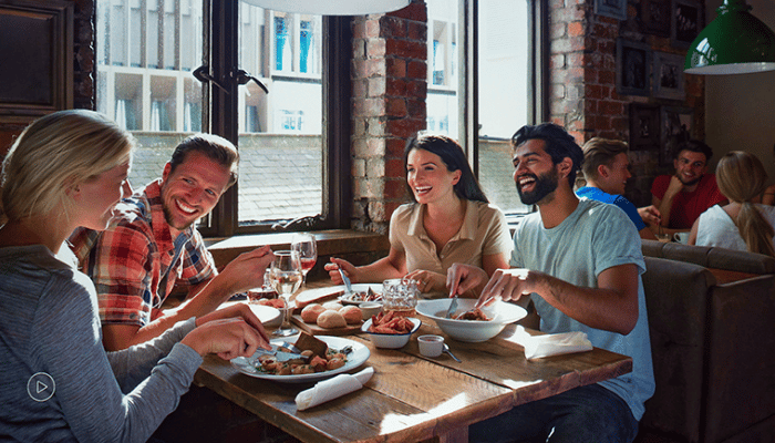

Optoma CinemaX P1 4K HDR actual screen shot

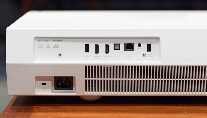

Optoma CinemaX P1 Power/noise/working temperature Test
- (Remarks: Ambient noise 39dBA; room temperature 23℃):
- Standby power consumption (connected with HDMI cable and network cable): 5.7W
- Maximum power consumption during work test (playing test clips): 285.8W
- Noise at the air outlet (highest brightness working mode): 45dBA
- Noise from 1 meter away (highest brightness working mode): 41dBA
- Air outlet temperature on the surface of the fuselage (maximum brightness working mode): 39℃

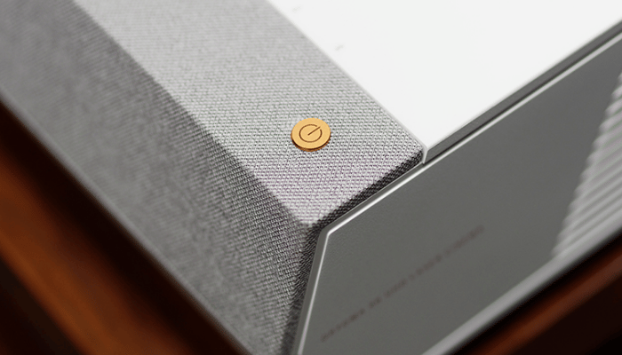

Optoma CinemaX P1 is one of the most well designed models in this comprehensive evaluation. The all-white and angular design is quite fashionable and avant-garde, and it can easily be integrated into the fashionable home decoration environment. , And the simplified design concept also adds a lot of youthfulness. In terms of size, Optoma CinemaX P1 can meet the needs of various complex installation environments.

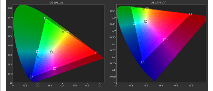

Optoma CinemaX P1 Projector Review: Color gamut test of preset mode in 4K HDR
The field test uses HDR mode. In this mode, the color gamut of the Optoma CinemaX P1 screen is close to 90% of the DCI-P3 CIE 1931 standard. It is worth noting that the white point is closer to D65, and the built-in color management and grayscale white balance fine-tuning function You can get more accurate color reproduction. In HDR mode (after screen adjustment, in highlight mode), the Optoma CinemaX P1 brightness of the 100-inch 1.2-gain anti-light screen projected exceeds 200nit.
