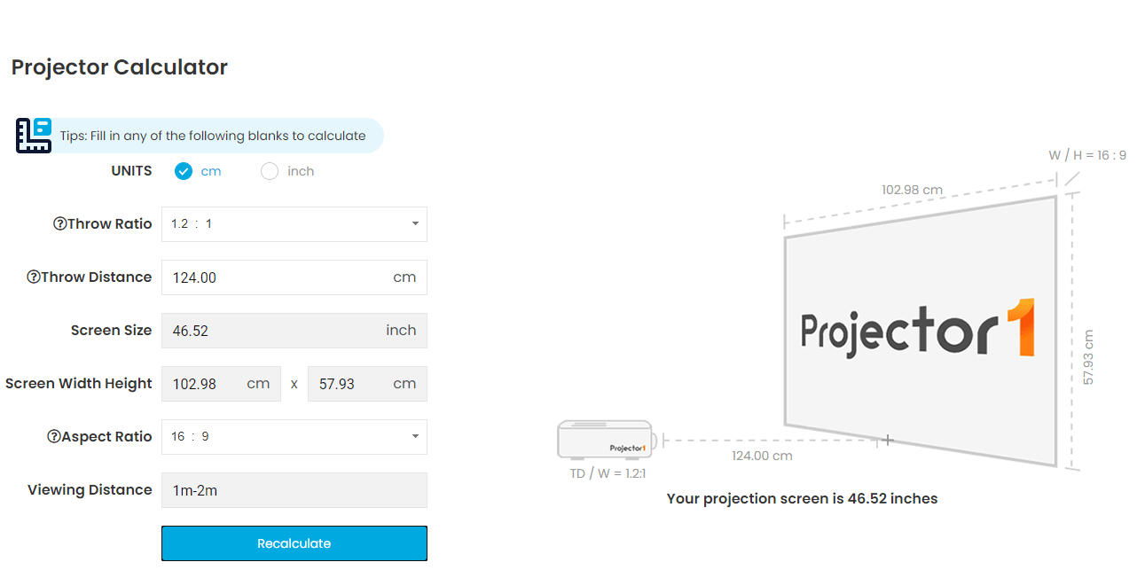

The size of the projection screen refers to the distance between the diagonals of the projection screen. The diagonal and the width and height of the screen can form a triangle. Users can choose the appropriate screen size according to the needs of their own home environment. In addition, before purchasing a projector screen, you can also calculate the most suitable projection distance and size according to the
Projector Calculator.
