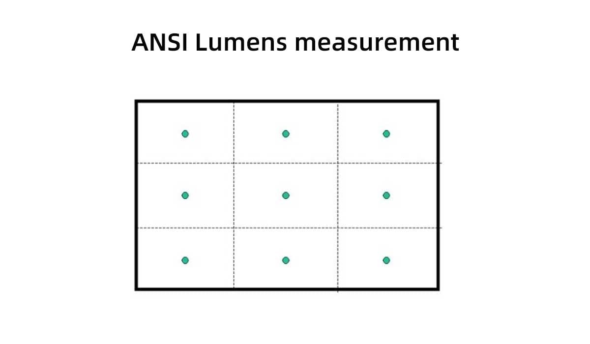

ANSI lumens is the international standard unit of luminous flux for projectors and is the method of measuring the luminous flux of projectors developed by the American National Standards Institute. It specifies a "nine-point" measurement method, in which nine points are used to measure the projected image under certain conditions, and then the average brightness of the nine points is calculated.
CCB lumens using the 13-point test method, on the basis of 9 points, increased the four corners of the test points, but this 13-point test method is to be considered.
ANSI lumens using the 9-point test method, is also a more internationally recognized test method, the use of illuminance meter illuminance sensor on the illuminance meter aligned with the center of the nine points, measured one by one, and record the measured illuminance value; the illuminance value will be added up to take the average, the average is the average illuminance of the screen, and then the average illuminance multiplied by the screen area to derive the brightness of the projector projected screen.
