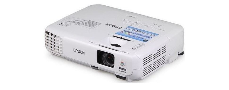

If the Epson projector automatically restarts or shuts down during use, the main reasons may be the following three situations.
The first reason may be the damage to the main board of the projector, the connecting cable, etc., which may be caused by poor contact. If such a situation occurs, please gradually verify which aspect has poor contact and take targeted countermeasures. If you lack replacement parts or the maintenance is difficult, please send it to Epson for after-sales service.
The second reason may be due to the projector's own protection settings. In order to protect the projector from being burnt due to excessive use temperature, the manufacturer will set the body temperature protection system before leaving the factory. When the temperature reaches a predetermined value, the projector will automatically power off to protect it from burning out.
If this happens, it is recommended to disassemble the fuselage, check whether the fan works normally, clean the fan and the ash layer of the fuselage regularly, and pay attention to the working environment of the projector, and try to avoid using it in a high temperature environment.
The third reason may be that the projector is similar to a computer and has its own set of systems. During use, the program is messy, which will also lead to infinite restarts or shutdowns. Press the reset button of the projector for five seconds to reset the projector to the factory state, which usually solves the problem.
