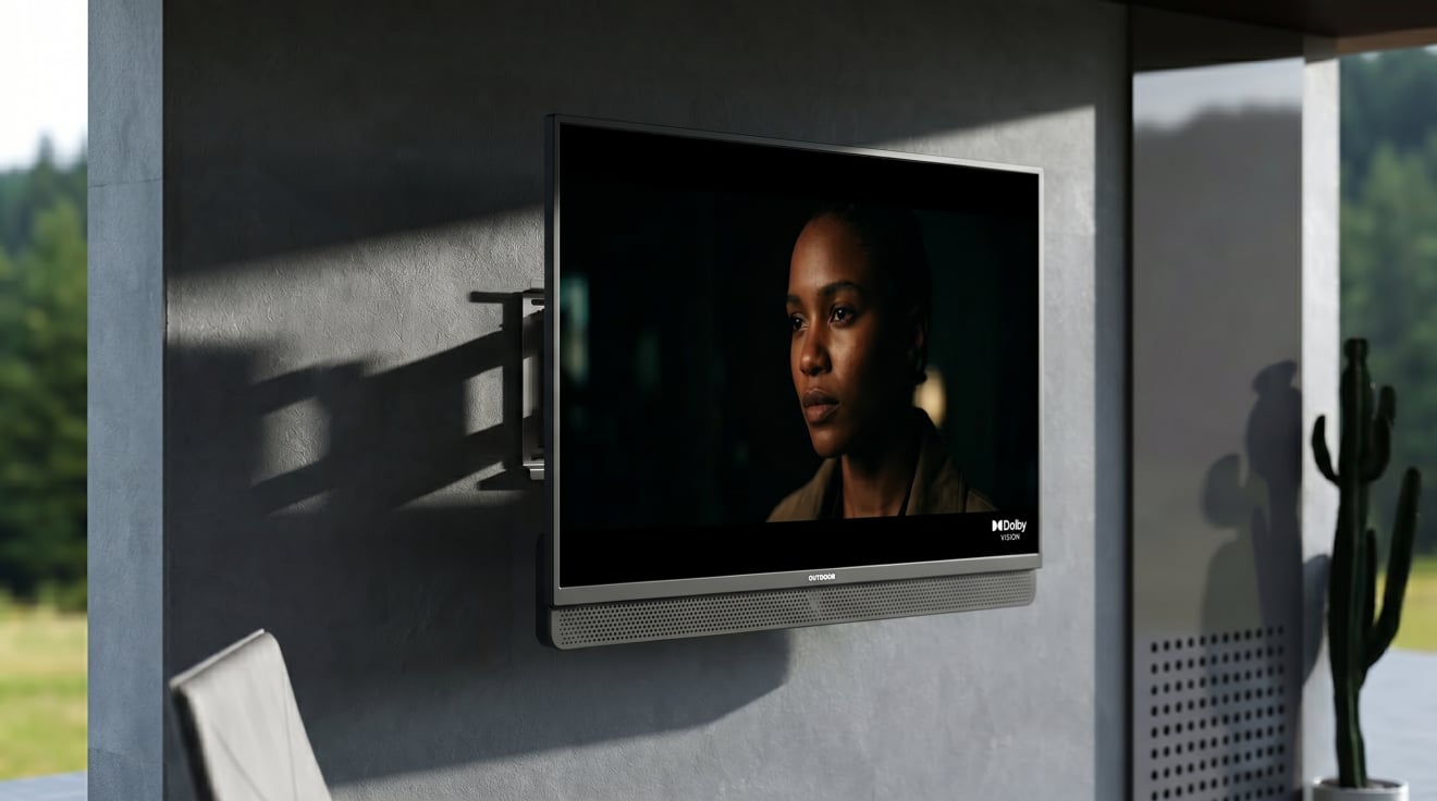

Step 2: Choose the right outdoor mount​
Three mount types for outdoor TVs:
Fixed (non-moving) — $80–$150​
Simplest, strongest, cheapest. No tilt or swivel. Best when viewing angle is directly in front.
Tilting — $120–$250​
Allows ±15° vertical tilt. Ideal for higher mounts (above-fireplace installations) to tilt screen down toward viewers.
Full-motion articulating — $200–$500​
Extends 12–24 inches from wall and rotates left-right, pivots up-down. Best for multi-position viewing (e.g., dining table + lounge seating). More expensive and more maintenance points.
For the BF-55ODTV: A fixed or tilting mount is sufficient for most installations. Only choose articulating if you need to view from multiple positions that aren't directly in front.
Outdoor vs indoor mounts​
Don't skimp — indoor mounts use plain steel that rusts within 6–12 months outdoors. Outdoor mounts use:
Galvanized or powder-coated steel (stops rust)
Stainless steel bolts (don't corrode)
Weather-resistant pivots and joints
A proper outdoor mount costs $100–$300 more than an indoor equivalent. Skipping this is a common shortcut that causes rust streaks down the wall within one year.
