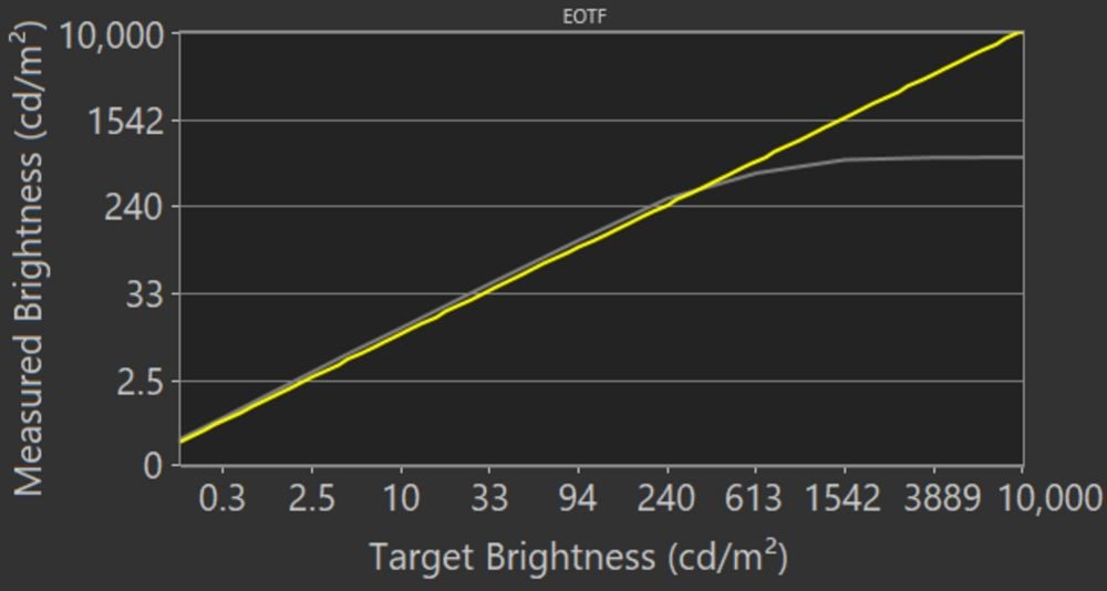

			1. Brightness and peak brightness
Measurement steps:
1.1 Adjust the MiniLED TV to the specified standard working state
1.2 Display a full white signal. After the signal display lasts for one minute, use a luminance meter to measure the luminance of point P0 in the center of the screen, and record the luminance value Lv
1.3 Display a 10% white window signal. After the signal display lasts for one minute, use a luminance meter to measure the luminance of point P0 in the center of the screen, and record the luminance value Lv1
1.4 Test 1%, 3%, 5%, 20%, 30%, and 40% according to step 1.3, and record them as Lv2, Lv3, Lv4, Lv5, Lv6, and Lv7
1.5 Select the maximum brightness value among Lv1, Lv2, Lv3, Lv4, Lv5, Lv6, and Lv7, which is the peak brightness Lv’
1.6 Record full white luminance Lv and peak luminance Lv’

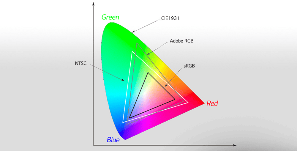

6. Color gamut coverage
Measurement steps:
6.1 Adjust the MiniLED TV to the specified standard working state
6.2 Display the full red field test signal, and measure the chromaticity value (uR, yR) of point P0
6.3 Display the full green field test signal, and measure the chromaticity value (uG, vG) of P0 point
6.4 Display the full blue field test signal, and measure the chromaticity value (uB, vB) of point P0
6.5 Take the measured (uR, yR), (uG, vG) and (uB, vB) as vertices to form a triangle in the u-v chromaticity diagram, which represents the color gamut
6.6 Calculate the integral ratio of the triangular area of the measured color gamut and the triangular area formed by the primary color chromaticity coordinates specified in ITU-T BT.2020 according to the formula, which is the color gamut coverage.
