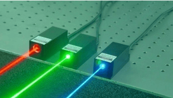

1. Light Source​
Laser TVs use a solid-state laser as the light source, while most traditional projectors use ultra-high-pressure mercury lamps. The life of a laser light source can reach more than 20,000 hours, according to 8 hours a day to calculate the life of at least 8.5 years, while the life of an ultrahigh-pressure mercury lamp is generally about 5,000 hours, according to 8 hours a day to calculate the life of about 2 years of time.
Because of the high cost of laser light source, it is a one-time investment and you don't need to replace it in a long term, so the price is also relatively high. The projector lamp, on the other hand, needs to be replaced regularly, with the laser life as the measuring stick, during which the traditional ultra-high pressure mercury lamp maintenance times are about 4-5 times.
