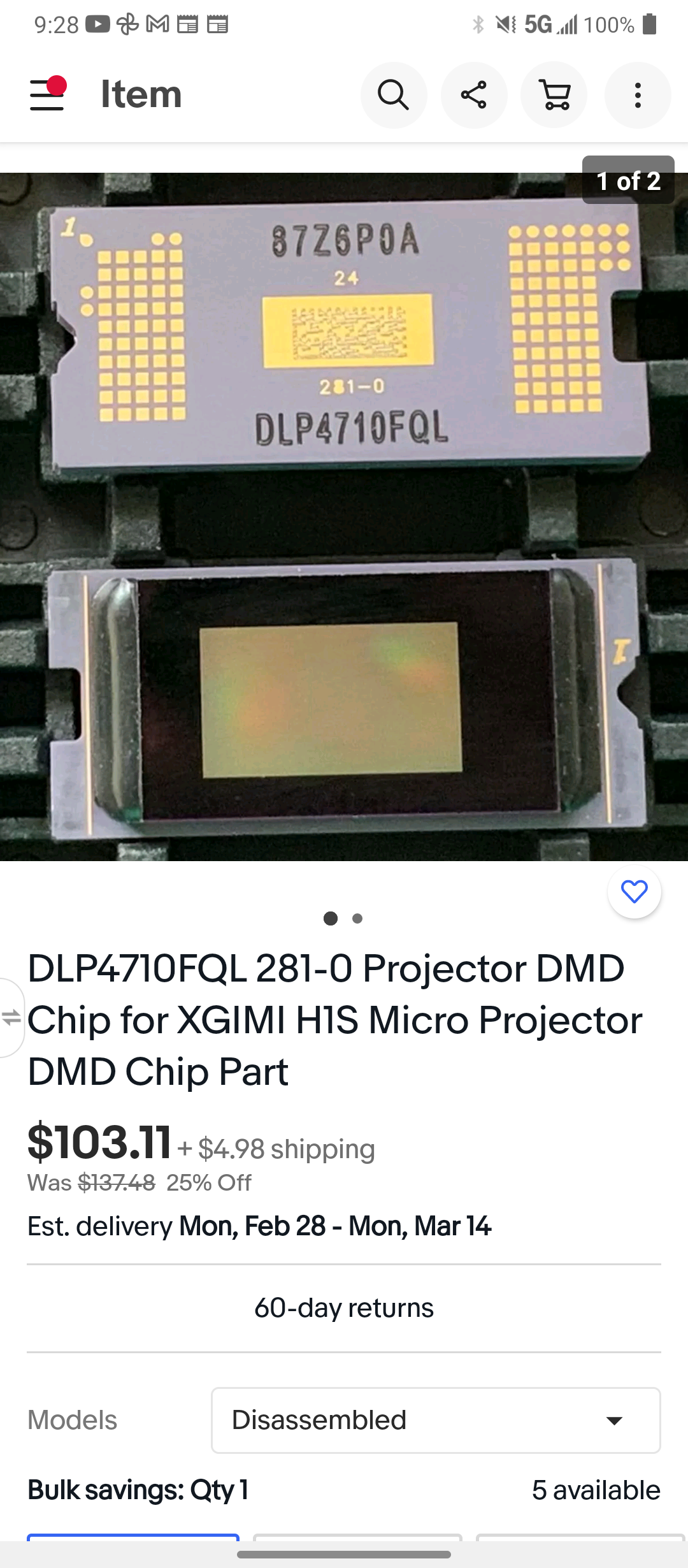

Shadowgaug3
This is what i found will it work on all three projectors?

Radiohead

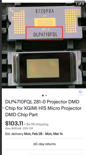

There're many kinds of 0.47 DMD chips, you need to make sure that what you buy is the same as your XGIMI or JMGO projector, and it's better that the tail suffix number is the same too. You can take the projector apart to see the chip number.
See what I circled on the pic.
