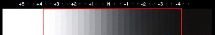

Then take the logarithm of 2 according to different brightness values, and then the values obtained are called stops on the image. See the picture below, from the darkest -5 to the brightest +5, it is called 10 stops dynamic range.
