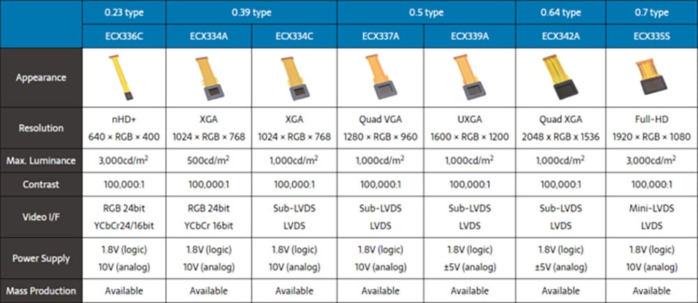

In addition to the common features of conventional OLEDs: single-pixel light control, high color gamut, and low response latency, MicroOLEDs also have the ultimate small size as their core advantage. Taking the MicroOLED product line launched by Sony Semiconductor as an example, some of the products are able to provide 2K-level resolution in the display area of less than 1 inch, and there are also 0.7-inch display products that focus on brightness to provide up to 3000cd/㎡ peak brightness with standard 1080p resolution and 3000+ PPI. At the same time, they have very low power consumption and can be widely used in a variety of portable devices.
