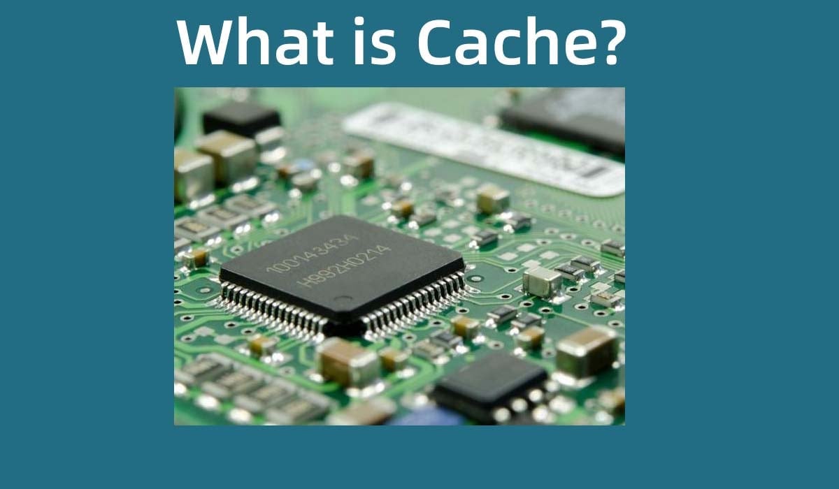

What is the Samsung TV cache?​
Every smart device has a cache, which is a storage area for temporary files, images, and other relevant information. It is useful whenever you open the app because it will serve the data from the cache faster.
However, as the cache size grows, the speed and performance of the running apps may suffer. As a result, it is always advisable to delete the device's cache on a regular basis to ensure that your Samsung Smart TV runs smoothly.
