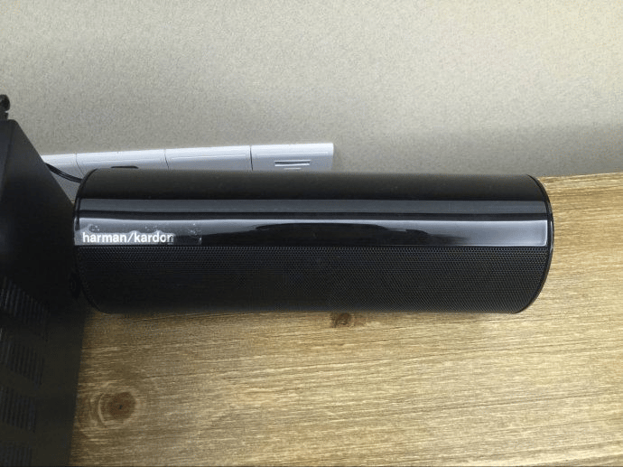

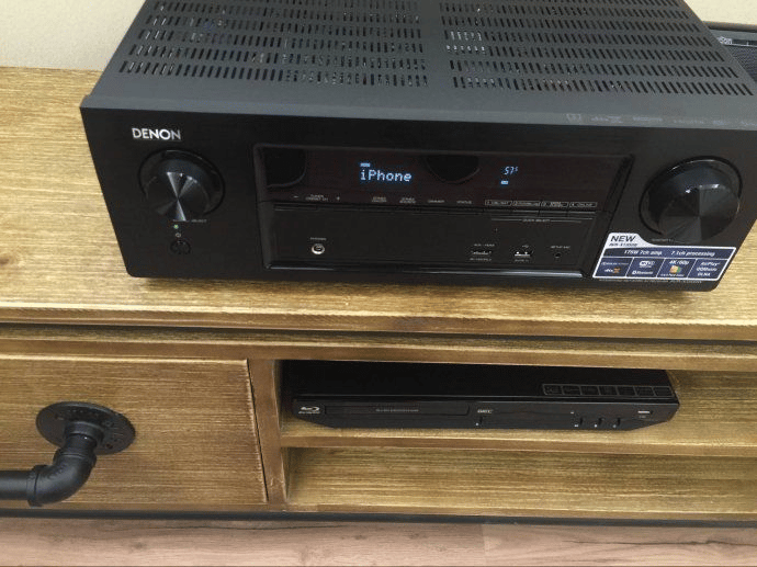

Here is a set of standard and simple 5.1 entry living room home theater, Harman Kardon 30 satellite with Tianlong AVR-X540 amplifier, the homeowner installed a home theater in the living room. The living room is not very big. Large floor-to-ceiling wooden speakers are undoubtedly inappropriate. They occupy space and affect the aesthetics. They also have higher requirements for the sound field environment. At this time, the best choice is to choose a set of good-quality satellite home theater speakers.

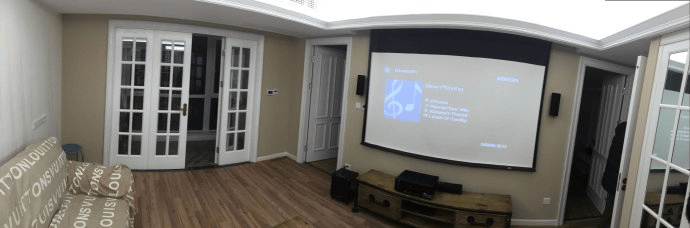

5.1 satellite home theater, high-definition projector and screen, the budget is about $ 2,500, watching movies can basically reflect the feeling of the theater, the sound positioning can also be realized, the signal of the set-top box TV is projected on the big screen, and the sound passes The cinema system is much cooler than using ordinary TV sets! Because it is a living room, the acoustic decoration is not considered in the design, and this cannot be too demanding.
Home Theater Scenes:
Disadvantages in this case:
In this set of home theater, the main amplifier speaker position is basically located at 2/3 of the screen, which is in line with the characteristics of the theater speaker layout, but the main problem lies in the position of the rear surround speakers and the emperor's position.

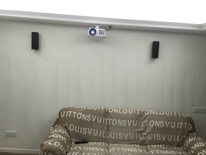

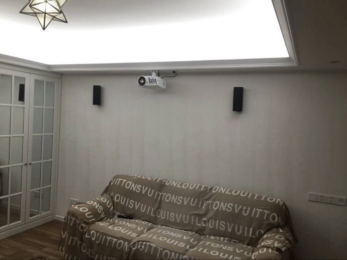

1. It can be clearly seen that its sofa deviates to the side of the surround back speakers, and is not placed in the middle of the two surround back speakers, which may cause unbalanced sound;
2. The position of the surround speakers is too high, the best position of the surround speakers should be equal to the ears when the treble direction is set;
3. The surround sound layout of the home theater is centered on the listener, and the best layout is an equilateral triangle. Therefore, the sofa should be placed in the middle of the room;
How to improve:If you often download and watch high-quality movies, friends who pursue surround sound suggest that they should try to install the rear surround speakers to the sofa placement position on both sides of the sofa, without affecting the decoration effect; Music is mainly used. When the environment at home cannot fully meet the sound field environment, choose 2.0 full-range bookshelf box. Friends who like the effect of shocking bass can choose the 2.1 combination system to meet daily use.
