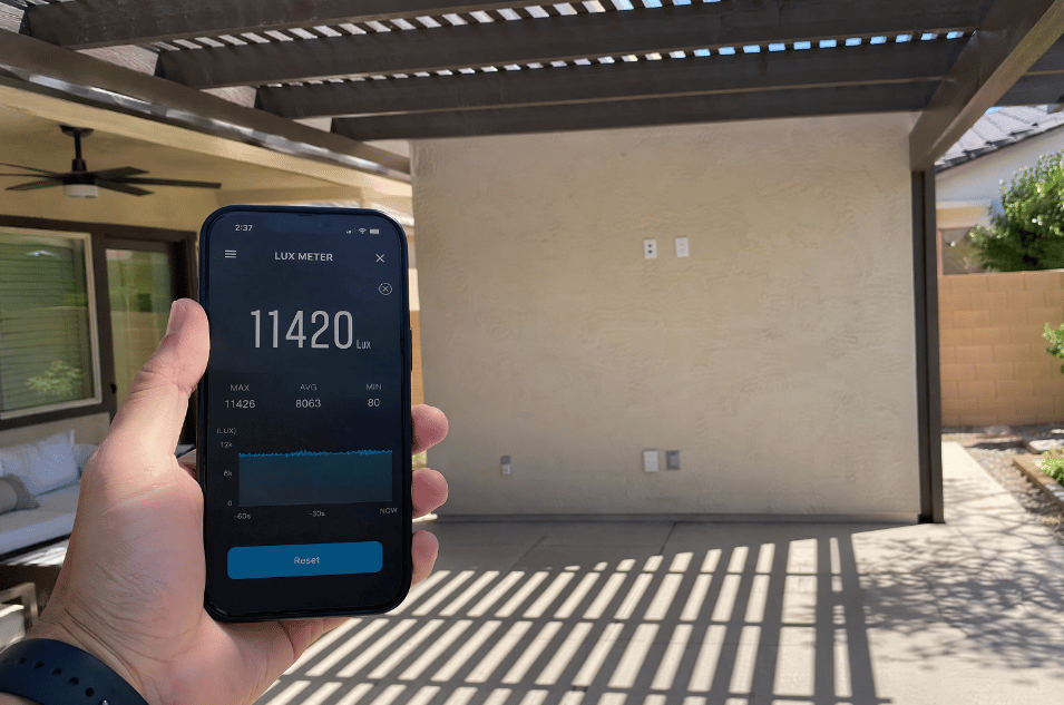

Marketing labels don't tell you anything about your specific install. Actual measurement does:
| Patio Type | Peak Afternoon Ambient Light |
| Indoor living room | 200-500 lux |
| Fully enclosed screened porch (no open sides) | 500-2,000 lux |
| Covered patio with solid roof and walls | 1,000-3,000 lux |
| Covered patio with solid roof and open sides | 1,500-5,000 lux |
| Pergola with shade slats | 3,000-8,000 lux |
| Pergola with open slats (most common) | 5,000-12,000 lux |
| Covered deck with open sides facing west | 4,000-15,000 lux |
| Open patio with afternoon partial sun | 10,000-30,000 lux |
| Fully exposed patio with direct overhead sun | 25,000-50,000+ lux |
| Pool deck with no overhead cover | 30,000-80,000+ lux |

How to Honestly Measure Your Install
Before deciding on TV brightness, measure actual conditions at your specific mounting wall:
The Smartphone Light Meter Test
Modern smartphones include light sensors. Free apps (Lux Meter on iOS, Light Meter on Android) measure ambient light in lux at any location.
Take Measurements at:
- 10 AM (morning sun angle)
- 2 PM (peak afternoon, often the most demanding time)
- 4 PM (late afternoon, especially demanding for west-facing installs)
- 6 PM (evening if relevant)
Record the Highest Reading
That highest number is your worst-case ambient light. Buy a TV with brightness adequate for that condition, not for the average condition or the convenient time you tested.
Common Mistakes in Self-Assessment
Buyers often misjudge their install conditions:
"My patio looks shaded." Visual assessment is unreliable. The same patio that "looks shaded" can register 6,000-8,000 lux during peak afternoon hours — clearly partial-sun territory.
"I'll only watch in the evening." Plans change. Friends visit during the day. Sports games run during peak afternoon. Once you have an outdoor TV, you'll find yourself wanting to use it during peak hours.
"It's covered, so it's shaded." Roof coverage prevents rain but doesn't necessarily prevent ambient light. Open-sided covered patios often receive more ambient light than buyers realize.
"It's mounted on the north wall, so it's shaded." North-facing mounts are best for glare management, but ambient light depends on the entire patio environment, not just direct sunlight on the screen.

Mistake 2: Underestimating Pergola Sun Exposure
"It's a pergola, so it's shaded" is a common assumption that doesn't match reality. Pergolas with traditional open slats let through significantly more ambient light than buyers realize.
Fix: Measure ambient light at the planned mounting wall during peak hours. Don't assume pergolas provide more shade than they actually do.

How do I know if my outdoor TV install is partial sun or full sun?
Use a smartphone light meter app to measure ambient light at the planned mounting wall during peak afternoon hours (typically 2-4 PM in summer). Readings under 8,000 lux suggest partial-sun conditions; readings over 15,000 lux indicate full-sun conditions. Take measurements at the times you actually plan to watch — not just convenient times — and at multiple times throughout the year if possible.

- Under 3,000 lux peak afternoon ambient → Shade-only spec adequate (700-1,000 nits)
- 3,000-12,000 lux peak ambient → Partial-sun spec sweet spot (1,000-1,500 nits)
- 12,000-30,000 lux peak ambient → Full-sun spec required (2,000-2,500 nits)
- Over 30,000 lux peak ambient → Premium full-sun with anti-reflection coating (2,500+ nits)
