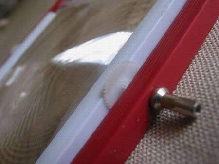

Trapezoidal adjustment mechanism close-up​
The close-up of the trapezoidal adjustment mechanism can be easily achieved by passing the bicycle wire through two plastic strips and adding a gear. How to transform a rice tank into a chassis

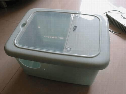

Close-up of rice tank​
The "concubine" Yu Zhao forgot to take it, I am really sorry. However, it is the simplest of the three frames, with no moving parts, and it is still a plastic strip plus a plastic sheet. This is the case, and you can guess what it is. I bought the "m-cylinder" from Parkn Supermarket, which is made of plastic and suitable in size
DIY LED Projector: follow the Steps to Get Your own cinema
The interior of the rice tank has been polished
The characteristic of this meter cylinder is that the length and width are just suitable for the size of the optical path, so the placement of the circuit becomes a problem. It happens that the height of the meter cylinder is relatively high, so I used a special "upper and lower structure" layout to integrate the circuit and electrical components. Placed on the lower layer, the optical path components are placed on the upper layer, separated by a plastic plate in the middle.

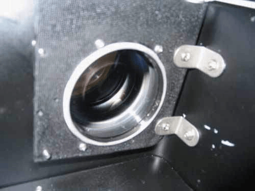

Fixed lens​
The lens is fixed on the small plastic board with small screws, and then the small plastic board is fixed on the inner wall of the chassis.
