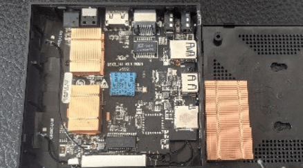

The things used are 5 pieces of copper, all attached to the back. The radiator on the front is 15 yuan, and three pieces are all attached to the front.
Except for the phase change of a CPU, the other is 922 silicone glue 5g WiFi connection, Tencent 1080p, Normally lay the desktop flat, and the CPU and DDR are both at 70 degrees.
x96max+: copper heat dissipation, the cost is not low, the effect is not ideal
In turn, the temperature of the cooling holes will decrease by about 5 degrees. Normal start-up operation is basically between 50-60 degrees, touch the box feel that the front and back are hot: Active heat dissipation, room temperature 32 °, startup about 37
