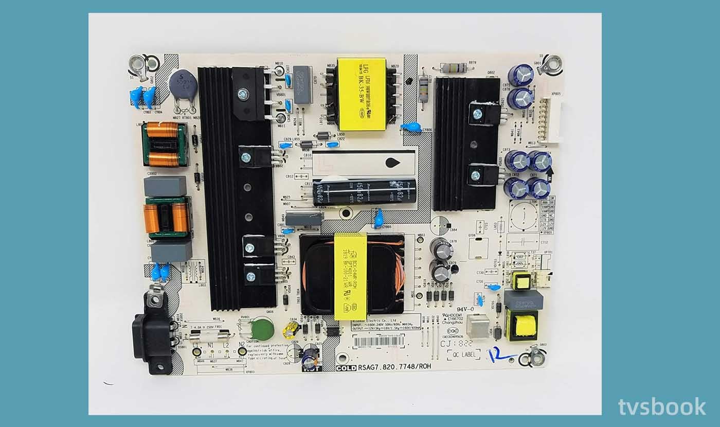

If your Hisense TV blinks red twice or more, it may be that your TV power board or capacitor has failed. Of course, different blinking codes represent different tips and have different fixing options. If you want to know, please continue to read on.

Hisense TV red light flashes 2 times no picture means the TV's hardware is malfunctioning. For example, the TV's backlight has been damaged, the power supply is aging, insufficient voltage supply and other problems can cause this error code.
Hisense TV red light blinks 3 times indicating that the internal circuit board of the TV is damaged, such as the capacitor of the motherboard being burned.
Hisense TV red light blinking 5 times is usually due to a cable connection error. This code can occur when there is a problem with the cable or power supply connected to your TV, for example, or when the TV power board is faulty.

Usually, the red light blinks 7 times representing a fault in the internal circuit of Hisense TV. For example, LED backlight, capacitor, or inverter board damage will cause this code.
Hisense TV red light blinking 8 times may be due to hardware failure or cable connection error. Circuit or power failure can cause this blinking code.

The Hisense TV red light blinking 10 times usually indicates that your TV's voltage supply is wrong, or that the power board is defective. In addition, incorrect cable connections and blocked vents may also cause this code.

If you have tried rebooting and resetting but your Hisense TV flickers and still flickers, it may be due to damage to your TV's motherboard.
If you are familiar with the motherboard and structure of your TV, you can turn on your TV to check where the fault lies.
If the capacitor is faulty, it may bulge or leak, and you can check the capacitor for distortion or corrosion. If there is nothing abnormal on the surface of the capacitor, you can use a multimeter to check the voltage and compare it to the expected/marked voltage of the capacitor.
If the TV's LED backlight strip or backlight inverter board is faulty, it will need to be replaced with a new one.
If you check for errors, it is best to take your Hisense TV to a professional repairer to fix it. If you don't know your TV, please don't replace or adjust the parts of your TV randomly or cause unavoidable damage.
